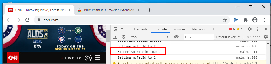

Are you try to spy an https website? I BP 6.9 and Chrome 83 using the extension 2.2.0 for BP.
To check if the extension is loaded when launching Chrome to your target site from BP, open the Chrome Console (F12) and check is the extension was loaded.

Thanks for your reply.
Even though the extension is loaded by Chrome it does not necessarily mean it works. Eg when using fixed port numbers.
