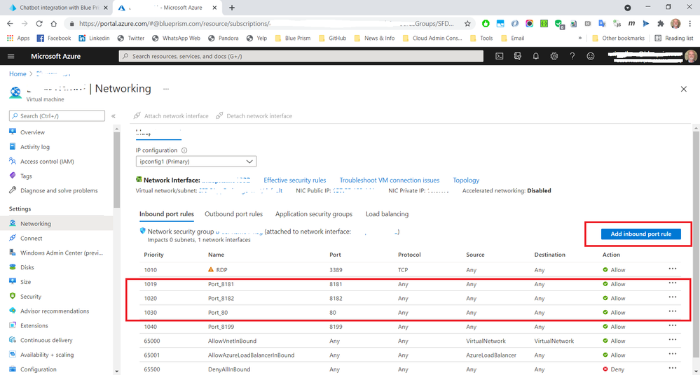

Assuming the first URL you posted is for a Blue Prism VM you created on Azure, you'll need to go in and configure the network settings within the Azure Admin Console. If you open the console in your browser and then click on your VM image you should see the Overview page. In the navigation panel on the left you want to click Networking.
On the Networking page, you need to click the Add inbound port rule button on the right side of the screen.
From there, you need to add rules to allow inbound traffic on port 8181, at a minimum. If you run additional runtime resources on this VM you'll need to open ports for them too.
@ewilson
We have already opened port 8181 in inbound rule of networking of my VM. pls see below attachment.
No additional runtime resources on this VM are created.
vinod chinthakindi

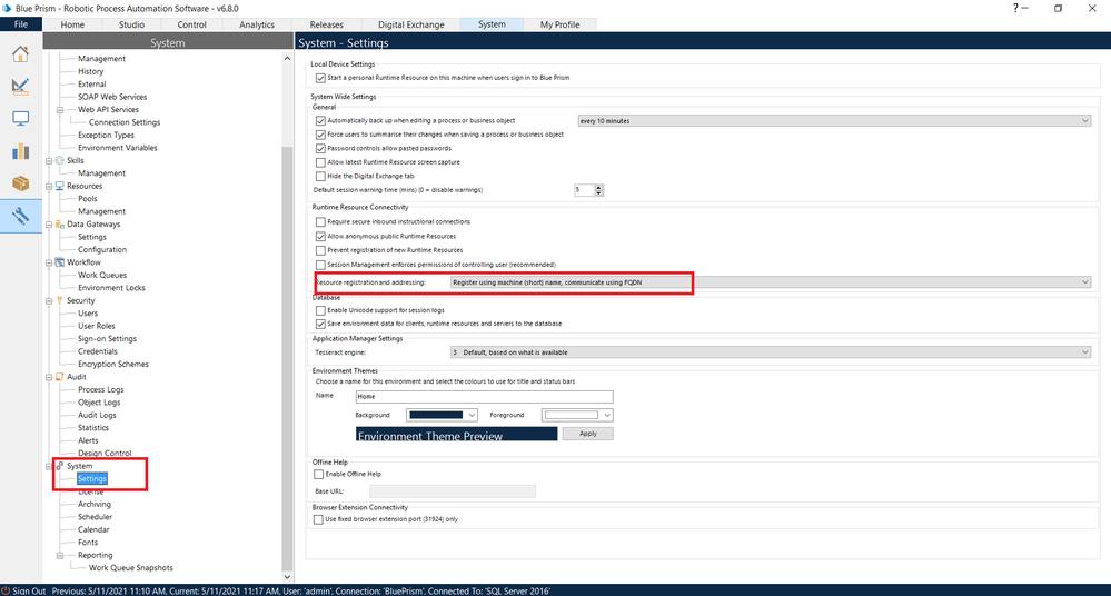

@vinod chinthakindi,
One more thing I thought about. You need to change the configuration of Blue Prism to specify that the default runtime resource communicate using the FQDN. See the attached screen shot.
You would also have to set this on the startup parameters of individual runtime resources.
