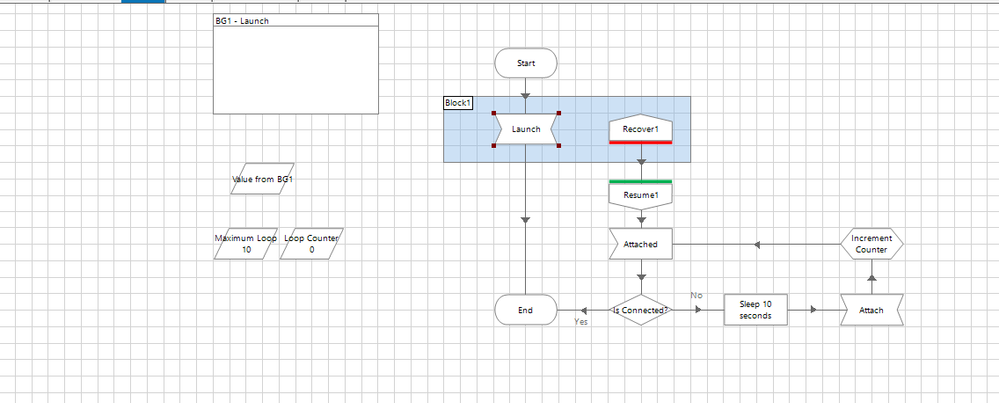

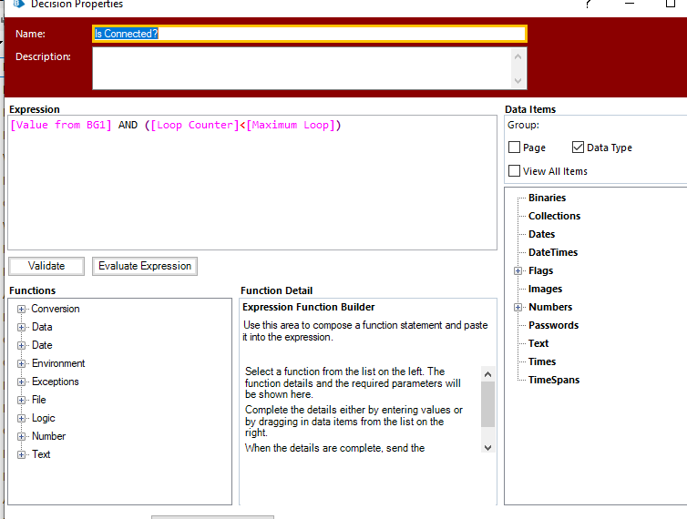

Hi Caleb,
We used to face this extension issue in 6.10 version in my previous organisation. In this case what we used to do as a turn around is have recover and resume on launch navigate stage have a sleep for 10 seconds and try attaching to the expected window. If the window is not loaded then retry for like 10 times (you can customize this value). This retry logic would attach to the launched window eliminates browser extension issue remarkably
