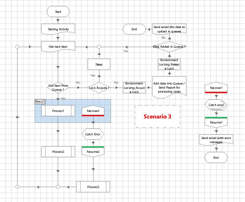

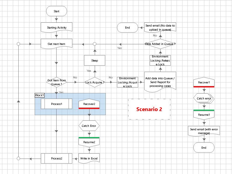

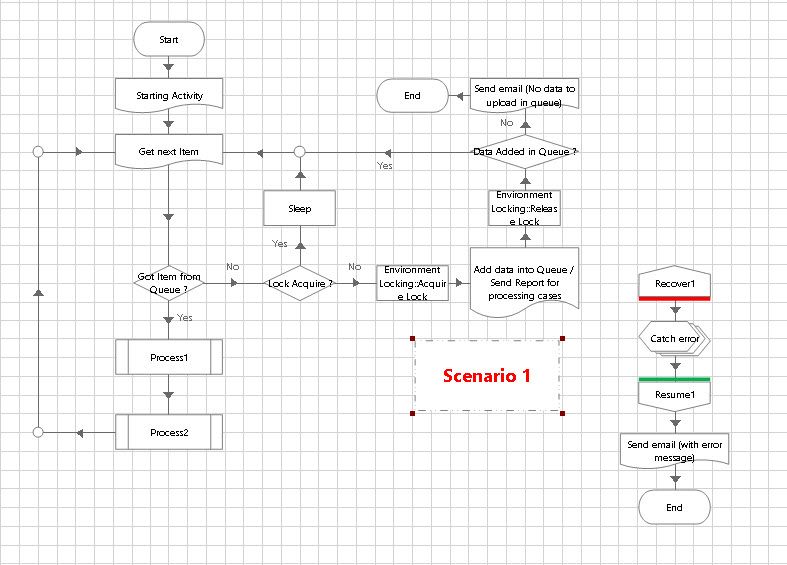

Hi Gavin,
Please check my attached solution, it might help you to achieve your goal however I am unclear about for below points.
·         You have not mentioned about your process work and requirements clearly.
·         You are calling process one by one, why do you need to know whether other bot has an error or not, it can be handled in the process only.
·         Schedulers are just to trigger the process.
·         Can you please add more clarity to help you in a better way.
Solution from my side.
·         I have created 3 different processes as per my understanding, as per your requirements.
P
Do let me know if you need more information.
