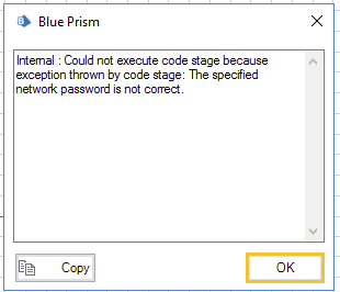

Then i tried to load .pfx file but I received this error this time:
I can install pfx on windows 10 which I'm using locally, but the running resource for the BOT is a Windows Server 2016 and I am still getting invalid password message when I'm trying to install the pfx there. But if I manage to install the pfx cert, then load it by VBO, could this fix the issue?

@Marek Mroc,
When you generated the PFX file, using OpenSSL, did you enter a password? If so, did you supply that password to the Load Certificate action when you tried loading the PFX file in the VBO?
Cheers.
Hi @@ewilson,
I did, I provided the pw but it was not working. So I generated the second pfx without any pw and the issue was the same.

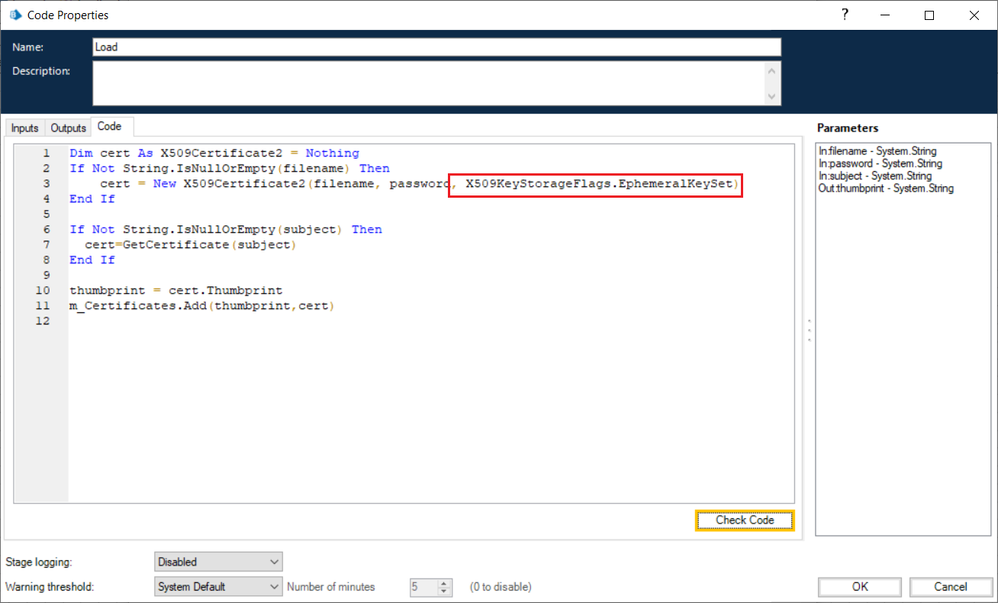

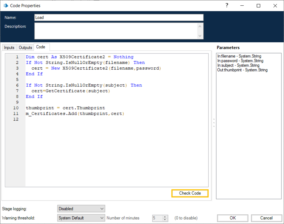

I think I know what's going on here. It seems that even though the private key is contained in the PFX file, the constructor we're using in the Load Certificate actions Code stage doesn't actually seem to read that private key. So, what you can try doing is change the Code stage from this:
to this (notice the highlighted change). This also assumes you will be using a password with the PFX file.

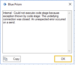

Hi @ewilson,
unfortunately I am still getting the same error

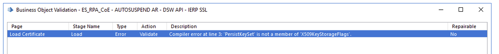

Hello @@ewilson,
this time I've got an compiler error 😕

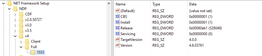

I checked the NET Framework setup:
