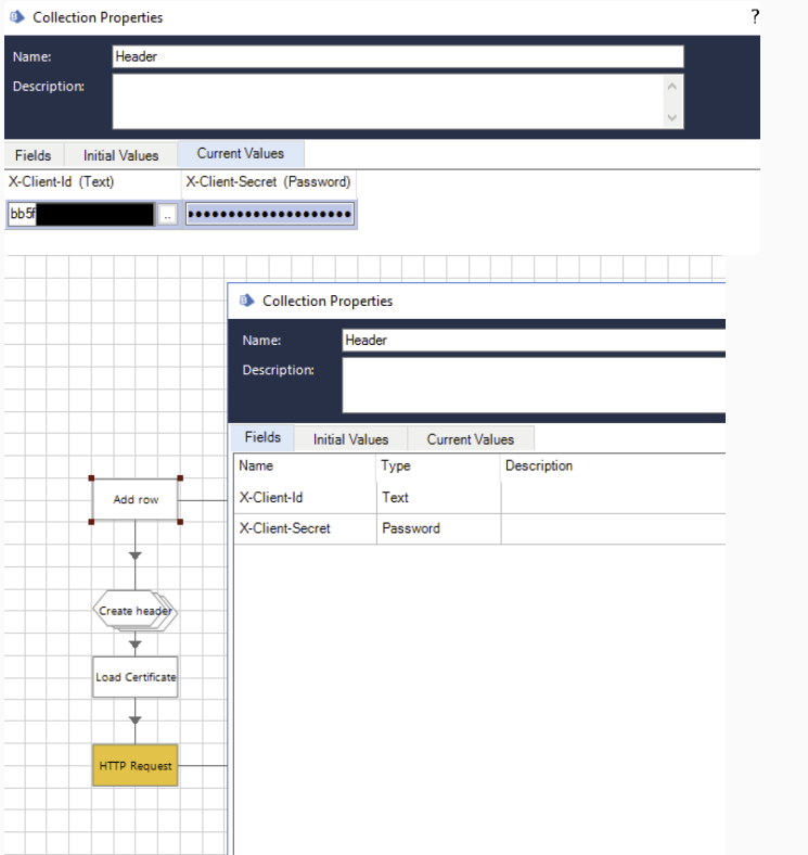

Hi Geoff,
the snip below is my setup from POSTMAN which is working:
As an parameter in the URL I am providing the Invoice Nr, I copied the whole URL and stored it in dataitem for a testing purpose but this will be changed accordingly to the process. Apart from that as a header I am sending X-Client-Id and Secret for authentication, together with the crt and key files in settings.
So in the BluePrism, I am providing the header only with the Client-ID and secret defined in the collection below:
URL which is copied link from POSTMAN and Certificate ID which I was able to load from crt, but due to the fact that I also need a private key, now im trying to load PFX file instead but no success so far.

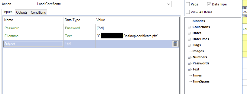

Hi Geoff,
sorry for this misunderstanding 🙂
As you can see only PW and path to file.

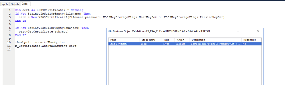

@ewilson, I tried both:
Marek Mroc
Hi Marek,

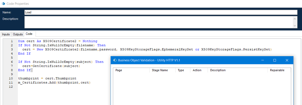

Could I suggest an alternative to Eric's response and that is:
X509KeyStorageFlags.EphemeralKeySet or X509KeyStorageFlags.PersistKeySet
and the other alternative as being:
X509KeyStorageFlags.UserKeySet or X509KeyStorageFlags.PersistKeySet
thanks

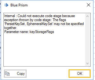

Hi Geoff,
when i used X509KeyStorageFlags.EphemeralKeySet or X509KeyStorageFlags.PersistKeySet I still hit an error but diffrent one:
X509KeyStorageFlags.UserKeySet or X509KeyStorageFlags.PersistKeySet cause invalid password error again as before.

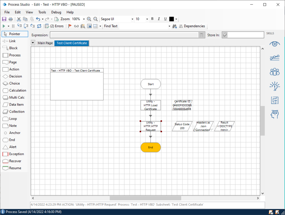

Hi Marek,
This is puzzling, as when I do this, I see this.
I don't see an error and I have tried this on frameworks 4.7, 4.7.2 and 4.8.
What version of Blue Prism are you working with?

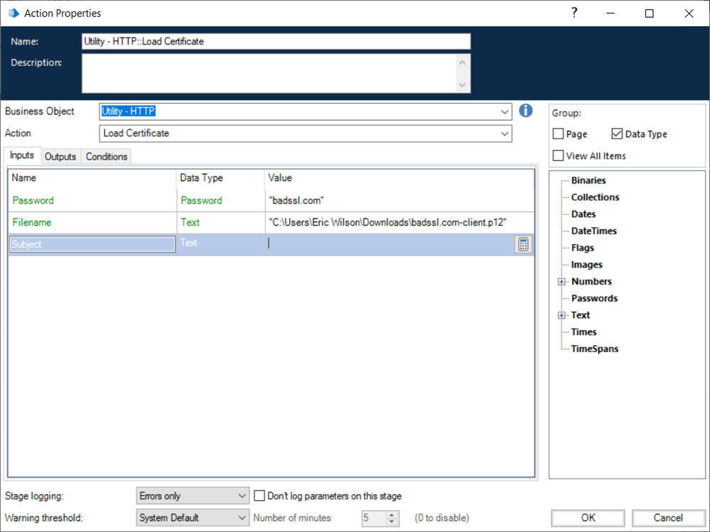

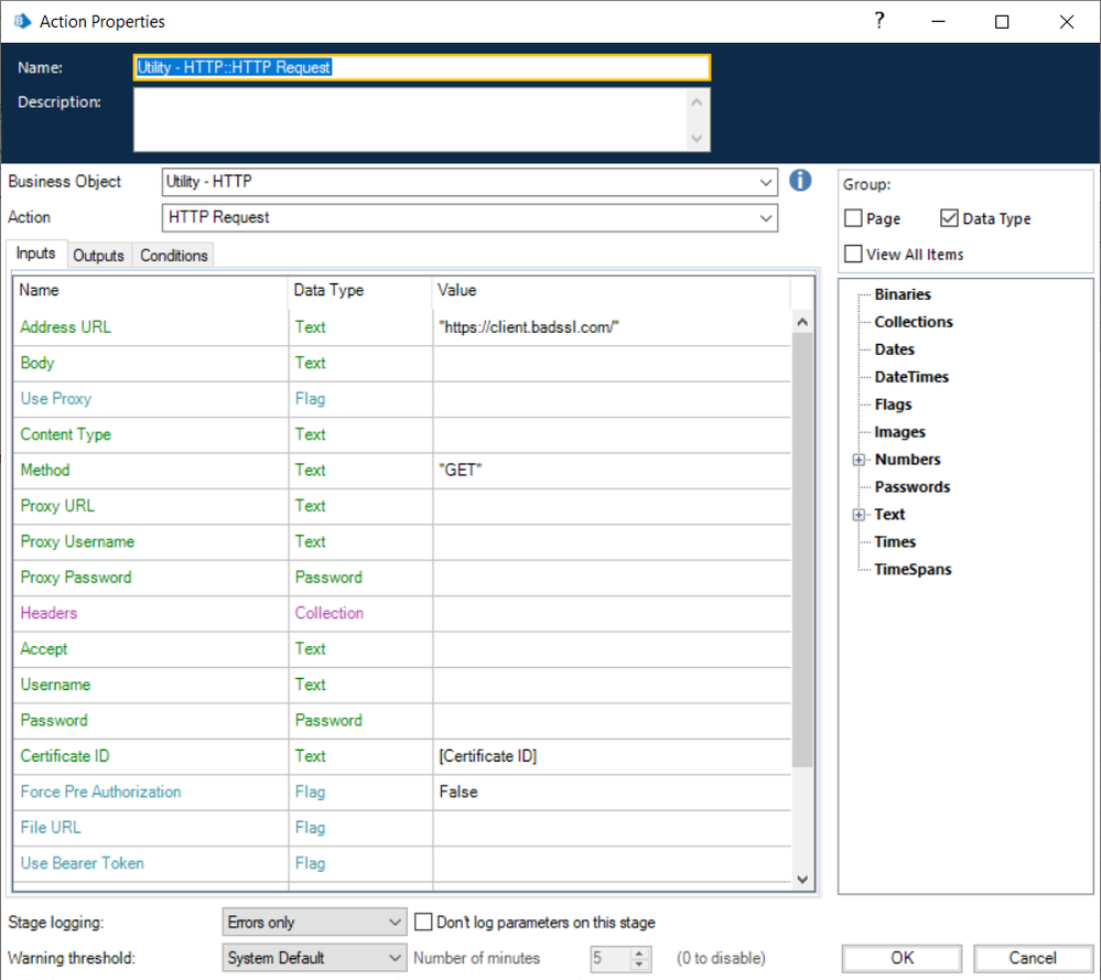

@Marek Mroc,
I've been doing some testing with a couple publicly available sites for testing client certificate authentication. What I'm seeing is that the HTTP VBO works as-is. As an example, https://badssl.com is one such test site. You can download their test client certificates from https://badssl.com/download/. I've downloaded their P12 file (which is the same thing as a PFX - both are PKCS 12 format). They list the password for the file on their download page.
If I use the Load Certificate action with the P12 file and password and then perform a GET request against ​their client cert test URL (https://client.badssl.com/), I receive a 200 OK.
In the above example, Force Pre Authorization can be either True or False - it doesn't really matter as it's focused on HTTP Basic Auth.
If I try loading the P12 certificate with an incorrect or missing password, I get the network password error you've seen.
This didn't require any changes to the VBO code. So I'm wondering if it's actually an issue with the certificate you have. You started with a CRT file, correct? This is normally associated with Unix/Linux servers and tend to make use of the PEM format. The PEM format isn't fully supported by .NET (well, it wasn't until .NET 5 I believe), so it may be a case of the certificate works fine with Postman (because Postman isn't based on .NET) but it has issues with Blue Prism.
Did you generate the original CRT file, or was it provided to you?
