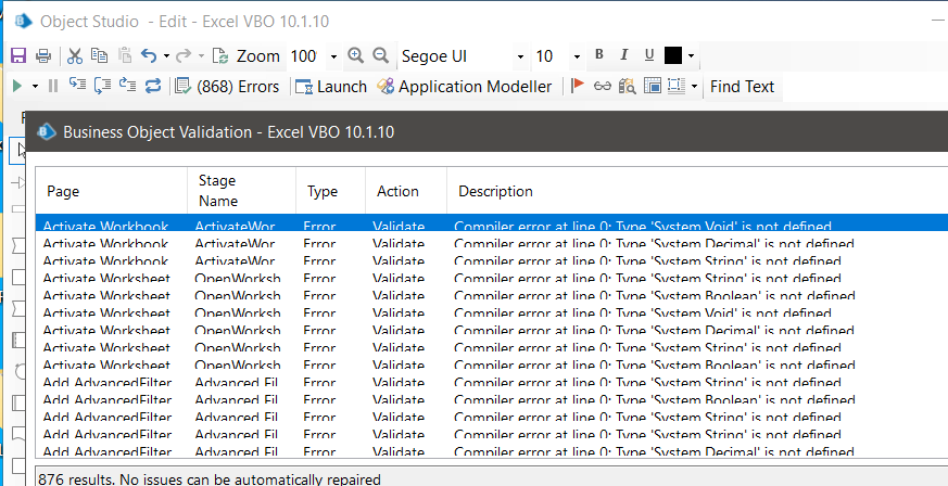

My research shows, that it's connected to the Microsoft Office 16.0 Object Library, thus there's no problem to call it via VBA. Soo, I should be able to reference the MSO.dll in the Excel VBO's Initialize page and use it in my code, right? Well, no. The moment I add mso.dll to the references, this happens:
So far I also had no success in using the Microsoft.InformationProtection.dll to create a valid AssignmentMethod object.

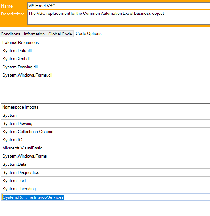

Here are the references:
