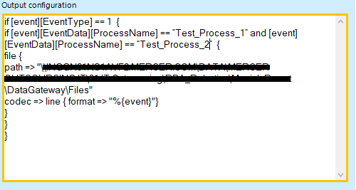

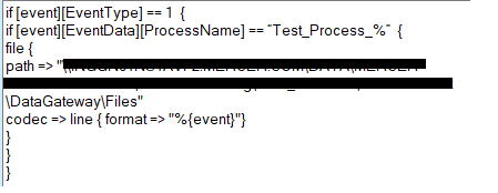

Hi Team,
We have 3 processes in the system
1. Test_Process_1
2.Test_Process_2
3. Test Process 3
I want to extract the logs of only Test_Process_1 and Test_Process_2 using DataGatway, I tried with below output configurations:
A:
B:
C:
But all are displaying the same result in DataGateway process through control room:
Can anyone suggest the right output configuration that I have to use?

Hi Manish
Can you test if it works for one of the processes ?
if [event][EventType] == 1 and [event][EventData][ProcessName] == "Replace with name of your process" {
file {
path => "c:\allevents.txt"
codec => line { format => "%{event}"}
Once you get it working then see if using OR clause works?
if [event][EventType] == 1 and (([event][EventData][ProcessName] == "process1") or ([event][EventData][ProcessName] == "process2")) {
Regards
Pritam
