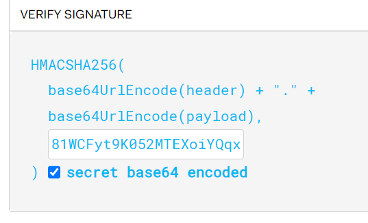

I am trying also trying to create the HAMC-256 signature with the below requirement from the https://jwt.io :
Please not that the "secret base64 encoded" checkbox is checked.
Any idea/code like below in how I can achieve that?
I have the header, payload and encryption key details with me.
ewilson
Hi @Manish Rawat,
In my experience, if you're trying to create something similar to jwt.io then you're looking at create a JWT (Json Web Token). The best way to do that, is to use an existing library. The one I've used in the past is JWT.Net along with BouncyCastle.
Take a look at this thread and you should see some example code I posted towards the end of the thread.
Eric
