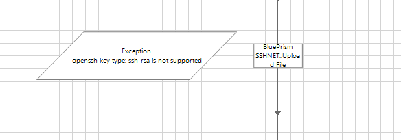

We have PEM file with private key in it. Any insights how can I transfer file using PEM file. I used same action but got below error.
Thank you,
Raj

Hi @Rajesh Kumar,
Can you tell me which version of the Renci.SSHNET.dll library you're using?
