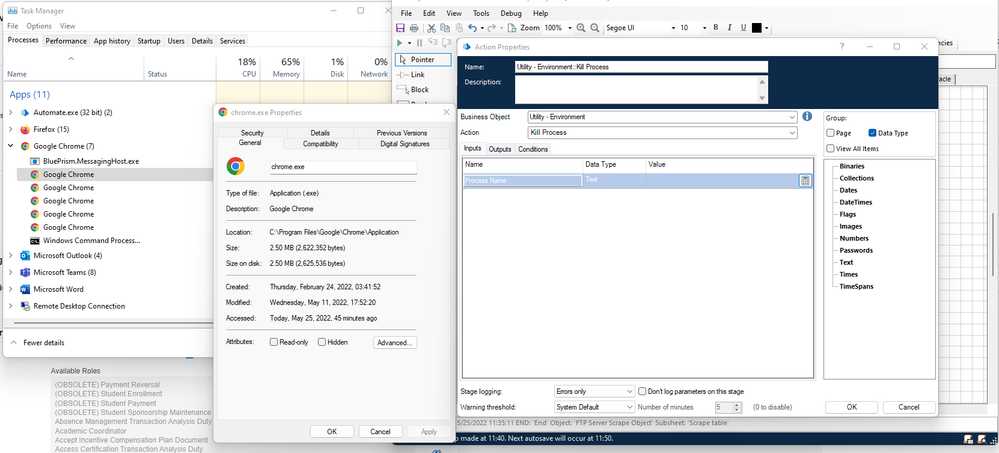

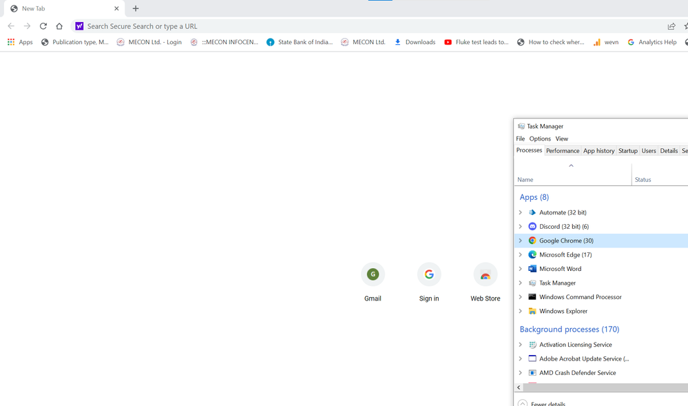

In order to kill any application using the 'Kill Process' action, you need to get the process name. To get the process name, keep your application opened up and then go to Task Manager:

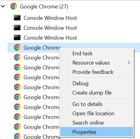

Expand the application and then right-click on any of the container applications being displayed there that you want to terminate and click on 'Properties':

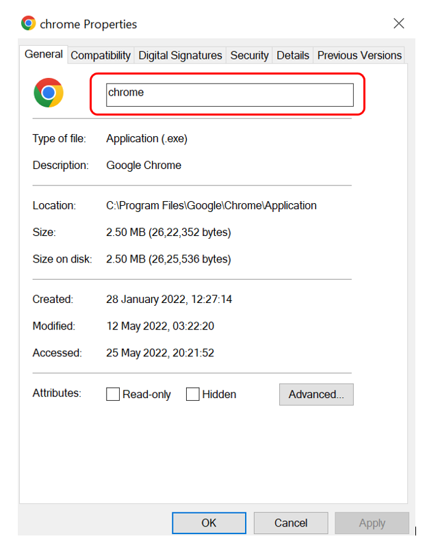

Now here in the next window you can see the actual process name that you need to provide:

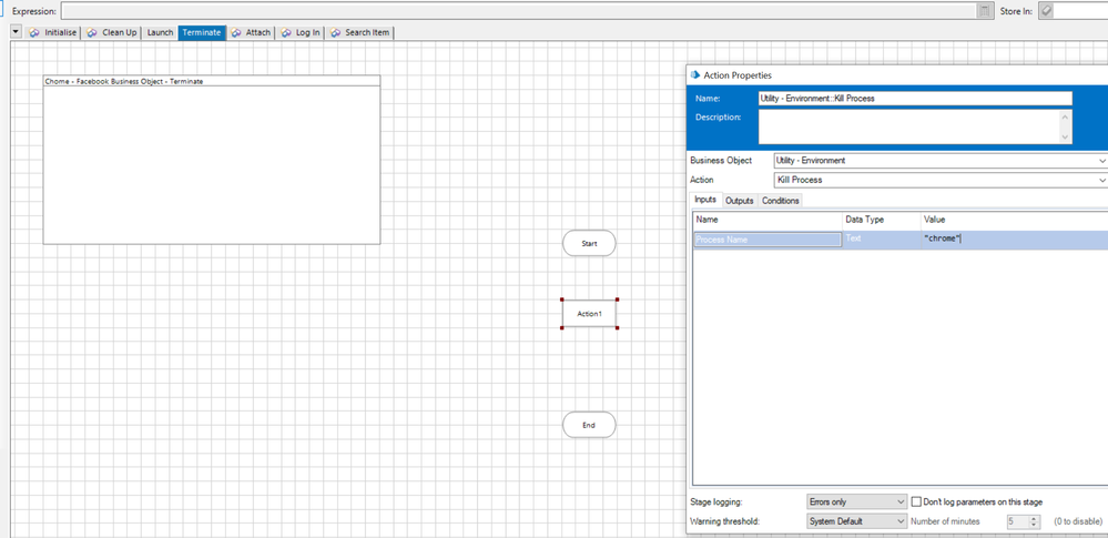

In your case, just provide "chrome" and it should work for you.
