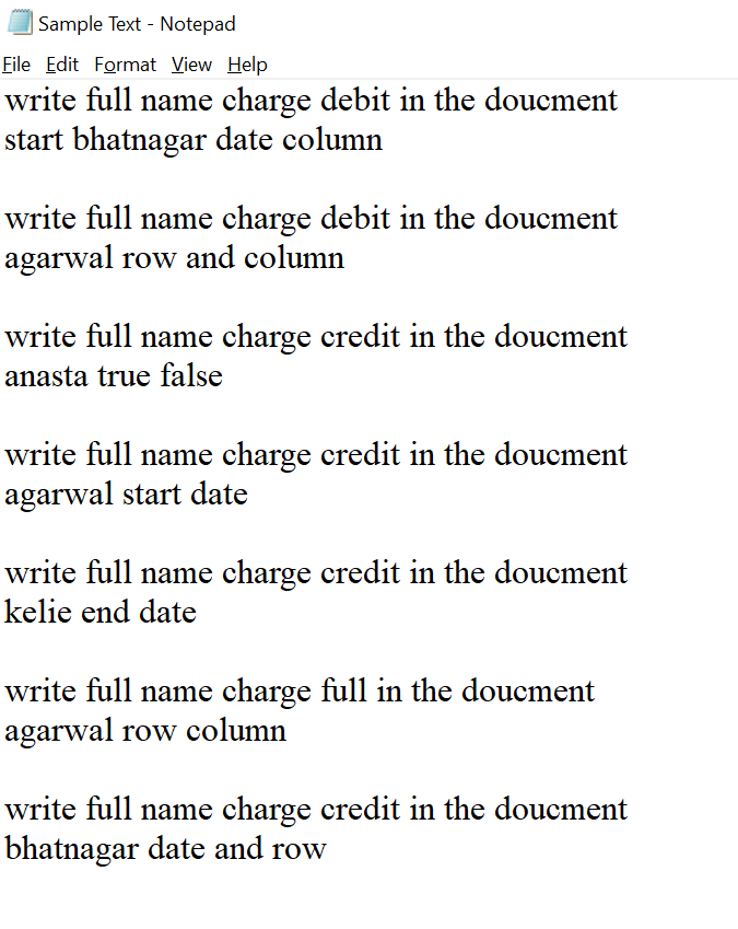

I have a text file. I want to perform following steps -
1. Find "agrawal" in the text file.
2. Wherever I have "agrawal", I want to read the line which is just above it.
3. Again, press "Find Next" for "agrawal" and read the line just above it. Keep doing this till search has finished.
Below is the sample text file.
Please suggest.
Thanks in advance !!

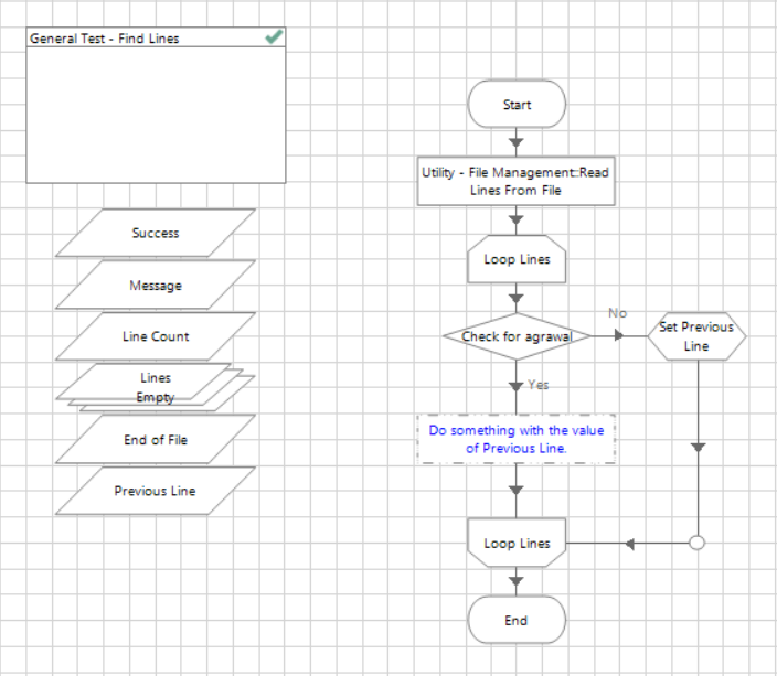

There are a few ways you could do this. You don't mention is you're trying to do this via UI automation or not though. The first solution that comes to my mind is to use the Utility - File Management VBO. There's an action called Read Lines from File. It will return a Collection of all the lines in the file. Then you could loop through the Collection looking for the lines that match your criteria. You would want to use a temporary data item to store each line as you go though so you have an easy way to recall the previous line when you match agrawal.
Does that make sense?

As mentioned by @ewilson, the best way would be to use Utility File Management and applying the logic using calculation stages. Otherwise, you can use below options as well to perform the same task:
1) Exporting data in Excel and then utilizing 'Find Text' functionality to identify the cell reference. Post identification of cell reference, you can move the cell reference by one cell up and you can get the data.
2) Using code stage if you want to perform the operation really fast and making it a generic code.
3) Using LINQ or OLEDB

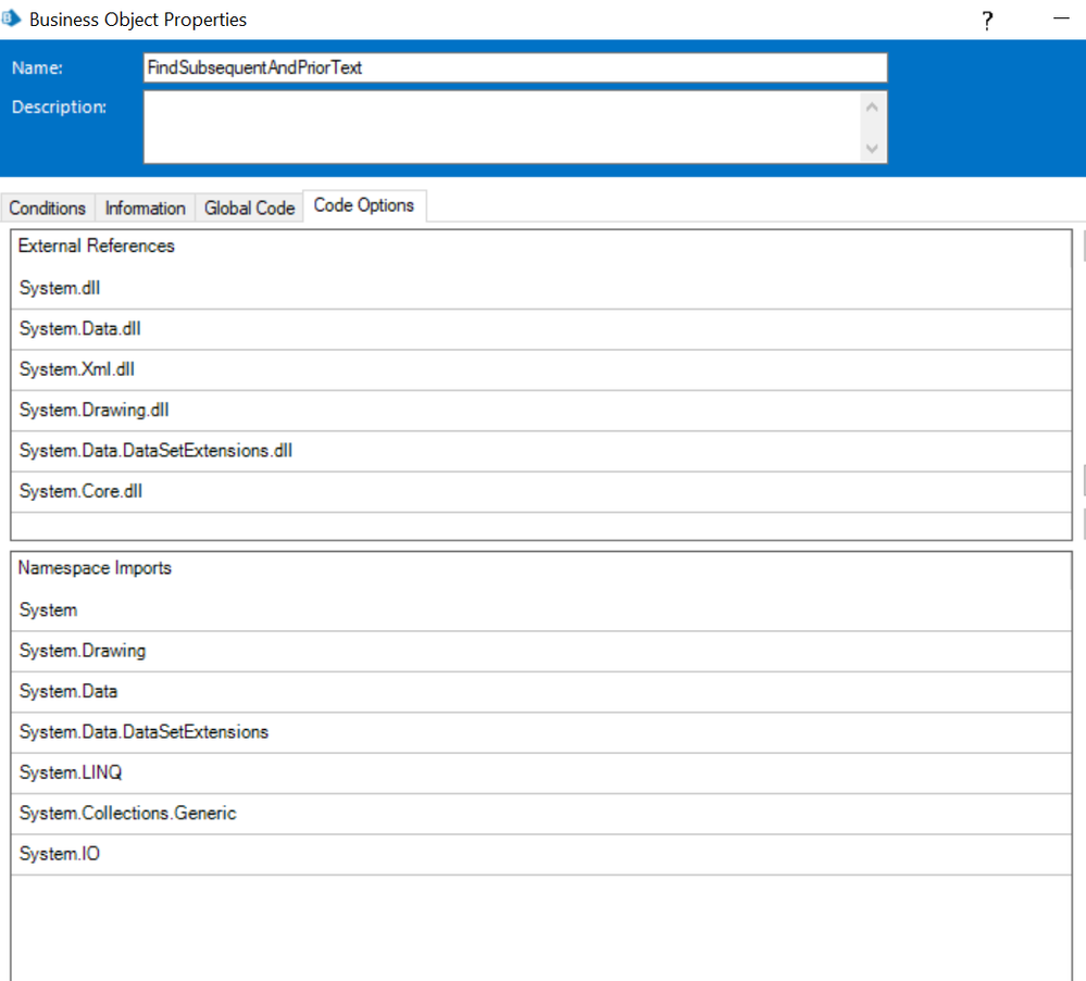

For your desired use case, I have created a code stage using LINQ and basic iterations that you can probably use. So first create a new business object and add the following 'Namespace Imports', 'External References' and 'Language' setting under the 'Code Options' tab of your page description stage in 'Initialise' action page:
External References: System.Data.dll, System.Drawing.dll, System.Data.DataSetExtensions.dll, System.Core.dll,.System.Xml.dll
Namespace Imports: System, System.Data, System.Drawing, System.Data.DataSetExtensions, System.LINQ, System.Collections.Generic, System.IO
Language: Visual Basic

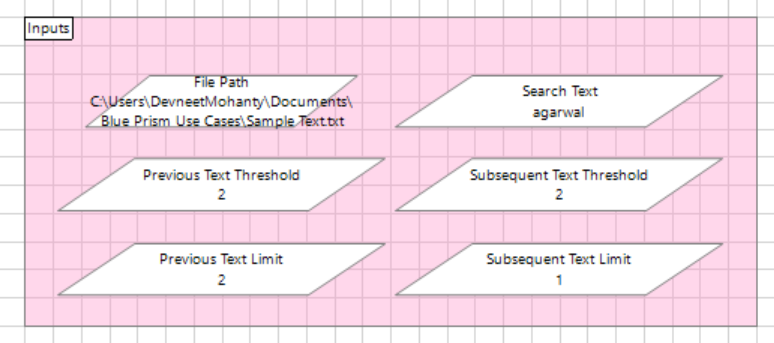

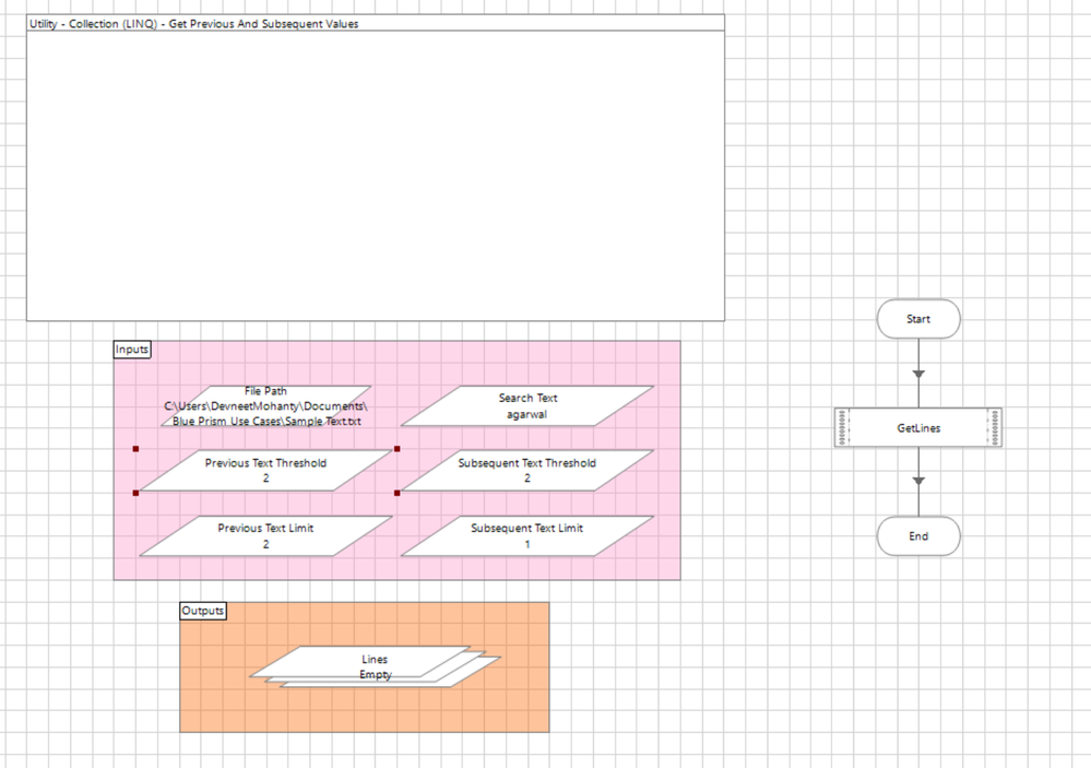

Now, you can create a new action page called as 'Get Previous and Subsequent Values' with the following input parameters:
- File Path (Text): The input file path of the text file where the operation needs to be performed.
- Search Text (Text): The keyword text to be used for search operation.
- Previous Text Threshold (Number): The starting index of the line relative to the line consisting of the keyword for which the previous text that needs to be grabbed in every continuation.
- Previous Text Limit (Number): The ending index of the line relative to the line consisting of the keyword for which the previous text that needs to be grabbed in every continuation.
- Subsequent Text Threshold (Number): The starting index of the line relative to the line consisting of the keyword for which the subsequent text that needs to be grabbed in every continuation.
- Subsequent Text Limit (Number): The ending index of the line relative to the line consisting of Subsequent Text Threshold for which the subsequent text that needs to be grabbed in every continuation.
Also, add an output parameter of type collection which should be an undefined collection. In my example, I have named it as 'Lines' as shown below:

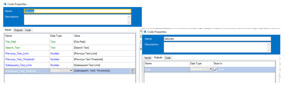

Add a code stage and map the input and output parameters as shown below:
Add the following code:' Initialize Local Variables
Dim previousText As String
Dim subsequentText As String
' Read Input Text File
Dim fileContents = File.ReadAllLines(File_Path)
' Get List Of Macthing Indices With Search Word
Dim matchingIndices= fileContents.Select(Function(x,i) i).Where(Function(i) fileContents(i).ToString.Contains(Search_Text))
' Generate Output Collection Schema
Lines.Columns.Add("Line Number", GetType(Integer))
Lines.Columns.Add("Previous Text", GetType(String))
Lines.Columns.Add("Subsequent Text", GetType(String))
' Iterate Through Each Item For Matching Indices
Dim row As DataRow
For Each item In matchingIndices
subsequentText = ""
previousText = ""
row = Lines.NewRow
' Add Matching Line Number Value
row("Line Number") = item
' Get Previous & Subsequent Text Values
Try
For i = Previous_Text_Limit To Previous_Text_Threshold + Previous_Text_Limit
If previousText = "" Then
previousText = fileContents(item + 1 - i)
Else
previousText = previousText + Environment.NewLine + fileContents(item + 1 - i)
End If
Next
For i = Subsequent_Text_Limit To Subsequent_Text_Limit + Subsequent_Text_Threshold
If subsequentText = "" Then
subsequentText = fileContents(item + i)
Else
subsequentText = subsequentText + Environment.NewLine + fileContents(item + i)
End If
Next
Catch ex As Exception
End Try
' Add Previous Text & Subsequent Text As Calculated
row("Previous Text") = previousText
row("Subsequent Text") = subsequentText
' Add New Row To Output Collection
Lines.Rows.Add(row)
Next
Now you can test the same with sample input file which in my case looks like this:
For the given input parameters:

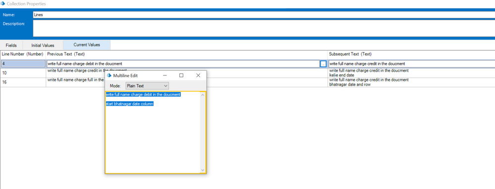

Following results are generated:
