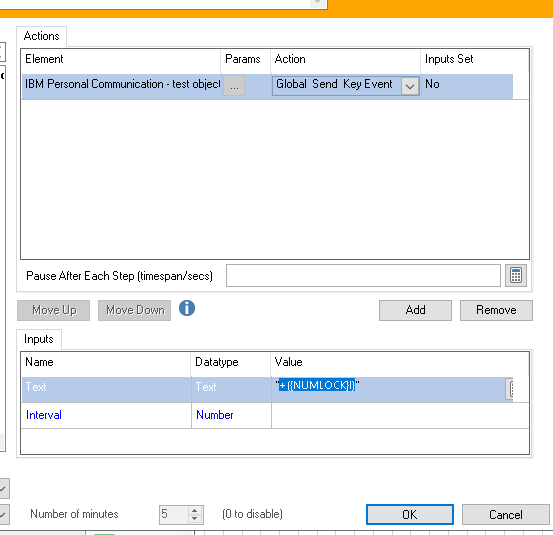

I'm trying to send Keys event to the application.
I need to hold down Shift, and during that send "NumLock" and "l" character.
(so it's like: HOLD Shift => HOLD Num => HOLD l  => RELEASE ALL 3)
19794.pngThis is text which I'm using:
"+({NUMLOCK}l)"
But it results with exception:
Could you support what's the issue?

MichalPlich2
Just wanted update here, what worked for me was "Global Send Keys" (not Global Send Keys Events) action, and as text parameter i've used:
"+({NUMLOCK}l)"
Thanks guys for your input!

Hi Michal
I always forget the correct structure for adding in multiple keystroke actions but if i remember correctly I think the syntax for this would be "<{SHIFT}<{NUMLOCK}l>{NUMLOCK}>{SHIFT}"

Thanks Michael,
You're right that my syntax was not correct, and I agree that yours should do the trick, but I'm still receiving the same exception:
Internal : Failed to perform step 1 in Navigate Stage 'Navigate1' on page 'Send keys event' - Unsupported key NUMLOCK
So this is how my action looks now:

Just tried and it worked for me mate . Can you check if your window is active and you are sending the key input to the top-most item in your filter tree.
