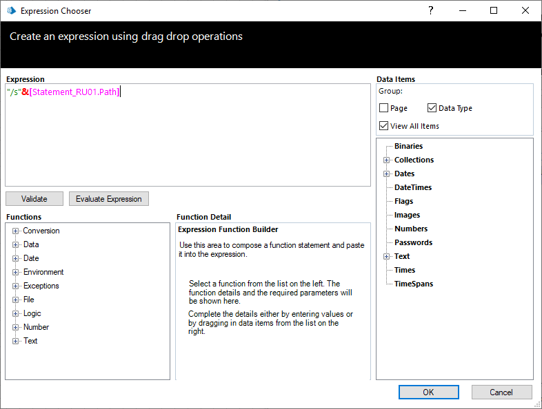

Hi , Bastiaan. This is expression is right for Argument?

Have you tried just using the Path itself? If you're having trouble with the syntax of including the /s then just try it without that. I've never needed it when triggering Adobe to open a PDF. Certainly include it if you find its necessary but no need to complicate your syntax unless you've tried it without.​
