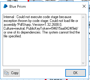

I have installed Object "PDF Management".
It works on my local computer, but my collegues are unable to use it.
Error message is in attachement.
Please tell me if you faced such issue and found solution.

The assembly (DLL) mentioned in the error has to be on every local machine that needs to use the VBO. Give the same DLL to your colleagues to place on their machines as well. It'll also need to be on the Runtime Resource machines.

All my colleagues has the same DLL.
This is not the reason of the error message.

Hi, Mateusz,
well, I agree with Dave that the reason is it can't find dll because that is what the message says. Can your colleagues try to copy the dll file in Blue Prism directory? It happened to me once that I put the right path in Initial Action - Code Option - it could not find the dll file until I put it in Blue Prism directory.

Hi Zdenek,
Yes it helps. When DLL file is in Blue Prism directory Object "PDF Management" works.
Unfortunately we cannot use this solution on our virtual machine. To input file in Blue Prism directory on virtual machine we need IT department assistance.  This is not available now and will not be for next months. We use others Blue Prism objects with DLL files saved in alternative folders and it works. I would like to use the same method for object "PDF Management"
We noticed that objects based on vb code works when we provide alternative path for DLL file. If object is based on C# code we have to input DLL file directly in Blue Prism Directory.

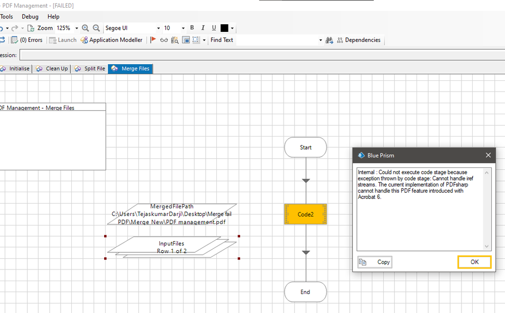

I'm facing below error with this VBO.
Looking for assistance.

@Tejaskumar_Darji,
Unfortunately, that is a limitation of the PDFSharp library. If you look at their FAQ you'll see that they do not implement all features of PDF v6 format. The only workaround, that I'm aware of, is to resave the actual PDF using the v5 format.
