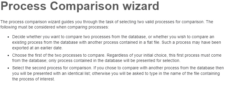

I was going through the below mentioned weblink to see how one can compare two different processes not two different version of same process.
but i am not able to find option to do that(although it is written in this weblink), all I can see is to compare two version of one process in System>Processes>History. am i missing something?
Process Comparison Wizard

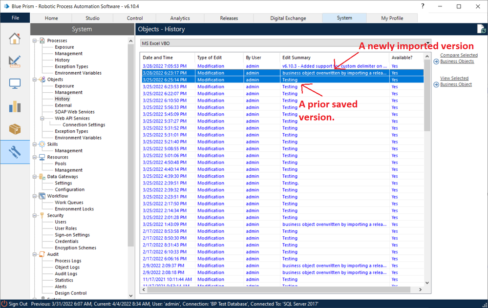

04-04-22 02:49 PM
The historical process comparison tool is what's available for comparing different versions of a process. What you have to consider is that every time you save a process you're effectively creating a new version. I imagine what you're looking for is a way to compare say a process you have already imported locally and a new version you may have downloaded from the DX. Is that correct?
If so, you can perform that action using the historical comparison tool too, but you must plan accordingly. What I mean by that is you should create a backup copy of the existing process (export the process as .xml or .bprelease). Then you can import the new version you have and perform a comparison between it and the last saved version. Does that make sense? After that, if you don't want the newer version you just import your backup copy of the process.
Here's an example using the MS Excel VBO. On my machine, I have a fairly extensive history of the VBO because we're adding improvements fairly regularly. The screenshot below shows the history along with the points that I've imported our latest release from our internal source code control repository.

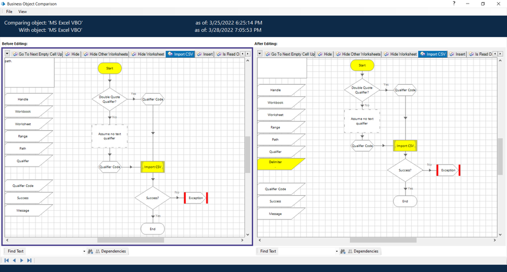

Now, if I highlight two different points in the history and click the Compare Selected Business Objects option, I'll be shown the differences.
Does that help?

05-04-22 12:12 PM
In the link i shared in my initial post, below is the snip from that. How to achieve the 3rd point.
I am not finding option to type the file name OR selecting the another process for comparison as mentioned in the BP doc link.
