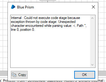

I have updated the servicenow link in the system tab with the link of the group where I see all the relevant tasks. I think using this link I can get the tasks in the collection. I tried running the Utility - JSON VBO but its erroring out at this error15424.png
My best guess was that the json doesnt have "" at the start and end which led to above error. So. I added " at the start and end but the fact that the whole script has " in it, which led to another error - "Additional text found after reading json..." because there are many " in the script. I guess if I pass this step I can get the tasks in the collection the way you suggested above.

Hi Bhuvnesh.
I don't know why you are getting this error. SNOW returns the JSON and the VBO converts it. I just ran this myself and it works fine.
