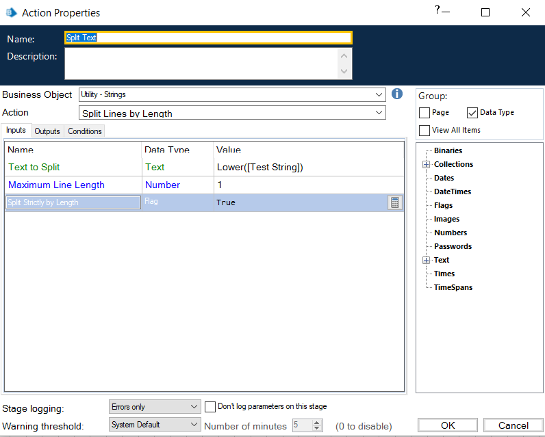

You can use a simple logic as shown below:
Here, first I used 'Split Text By Lines' action from 'Utility - Strings' VBO :

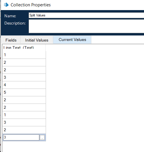

Next, I've iterated over the 'Split Values' collection using a Loop stage which has the following values:

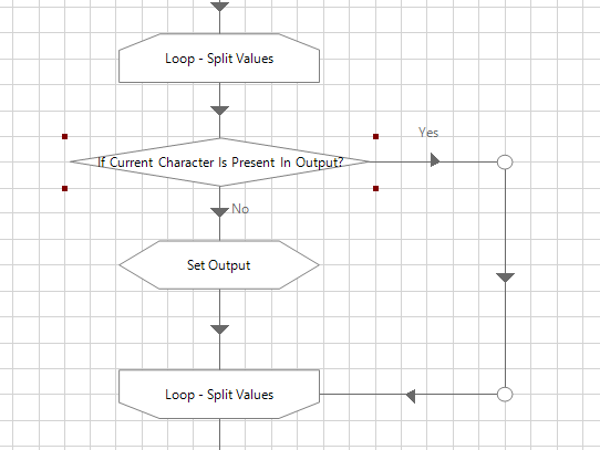

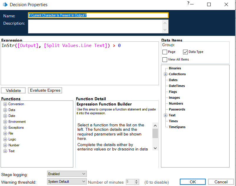

Next, I have used a decision stage to check if my current character exists in a 'Results' (Text) data item or not which initially would be blank:

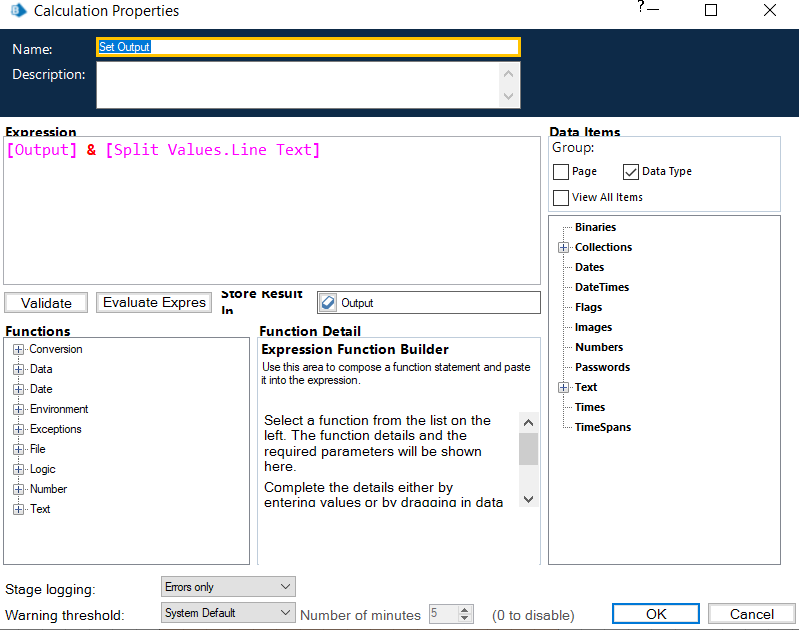

If the value exists, I simply skip over the iteration otherwise I will add the value to the 'Results' data item:
