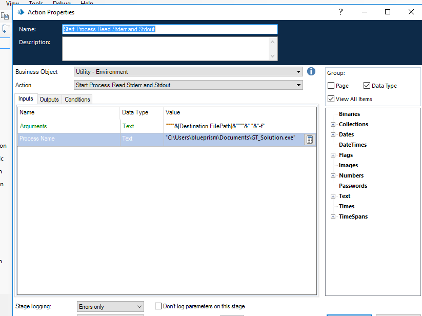

@Shakirat Jimoh can you post a screen shot of your settings for the VBO?​
Hi Eric
Find above the image for the VBO Settings.
Shakirat Jimoh
programmer
Waje smart solution
Africa/Lagos
Just to be clear, you're trying to run a Python script using the Utility - Environment VBO, correct? What I see in the screenshot is an executable file that you're trying to call with some parameters, so you're executing something like this:
C:\Users\blueprism\Documents\GT_Solution.exe "C:\SomeFilePath" -f​
Typically, executing a Python script on Windows involves a reference to the Python interpreter which would look something like this:
C:\python3 HelloWorld.py [Parameters]
There is an actual Python execution VBO available on the DX. Have you tried that as opposed to the Utility - Environment VBO?
One thing I would recommend is to change your parameter data to something like this:
Chr(34) & [Destination FilePath] & Chr(34) & " -f"
I don't think this change will impact the error you're seeing, but it will make you're data easier to read and maintain.
