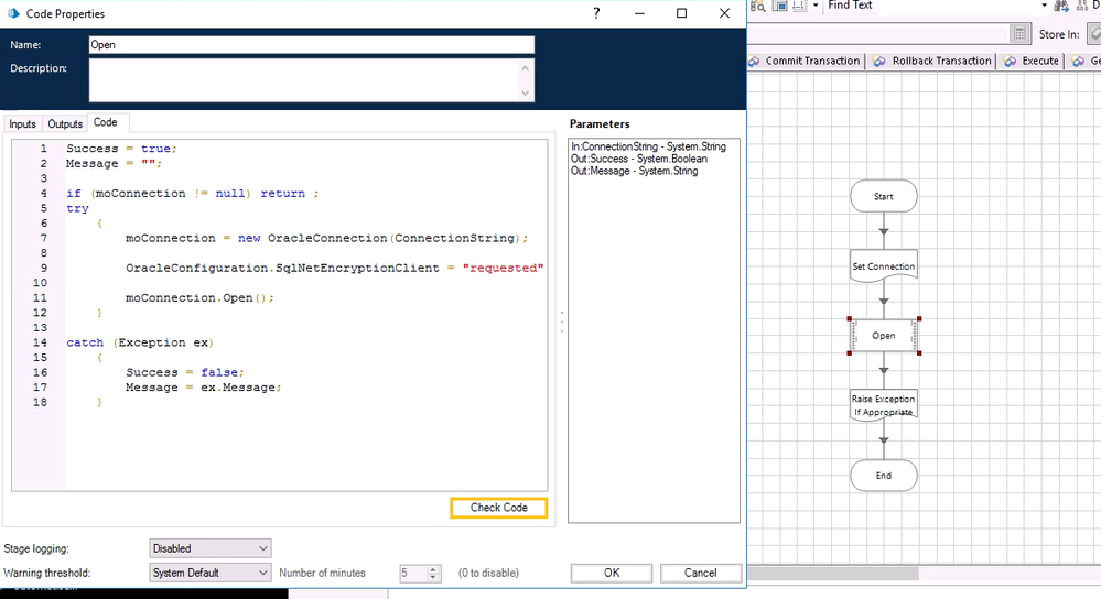

I've been scouring Oracle documentation, but I'm not seeing an equivalent attribute for setting the encryption type via the connection string. Instead, it looks like you may have to do it within the actual Code stage​ of the Open action. Try changing the Code stage to look like this:
NOTE: I have not tested this myself.

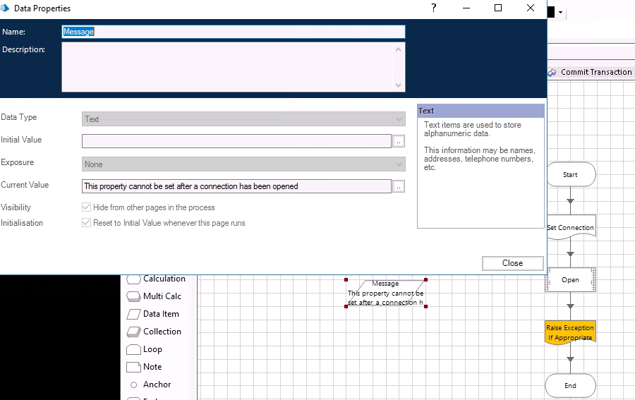

I have tried the solution you have mentioned, but i'm getting this error at the Open code stage when trying the Get Collection process example :
'This property cannot be set after a connection has been opened'
any insight on this ?

That's strange. Did you add the new line of code before the call to the .Open() method as in my screenshot?
Eric​

indeed, i added the line exaclty as shown in your screenshot. here's a look at my code stage :
35236.png​

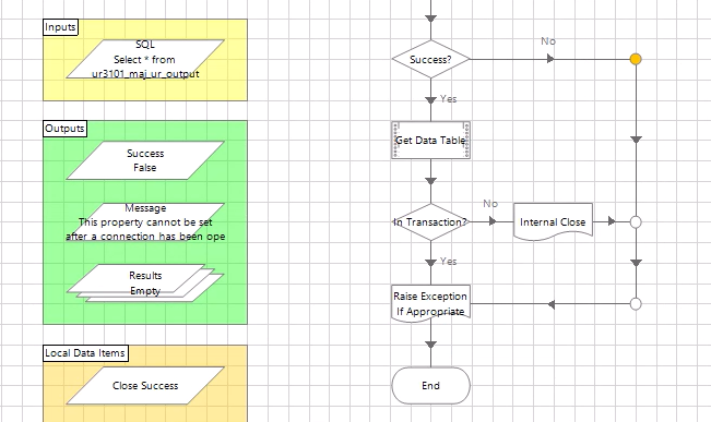

here's the error i encoutred :
this leads to the code stage Get Data Table being skipped :

Thanks for verifying @Raed Ammar. Does this error occur immediately on your first call to an action in the VBO or only on subsequent requests? The reason I ask is that the call to .Open() is obviously after the step where you're trying to set that property.
Eric​

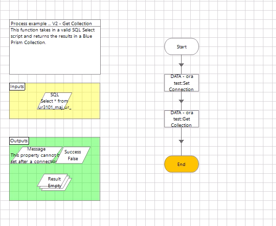

The process i'm currently using to test the connectivity to said database is Get Collection :
i always refresh and reset the process before running it step by step, so i would say it occures during the first call

Ok. Try moving the SqlNetEncryptionClient call to the first line within the try{} block.
Eric
