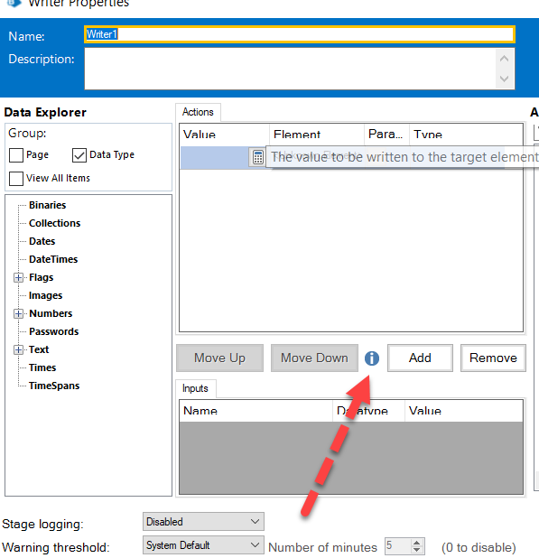

16-08-23 11:58 PM
Hi Jiaqi,
You can open any stage in the object and select "i" icon to open the documentation .
You can also open by navigating Help --> API documentation --> Select the object. As Athibhan highlighted
