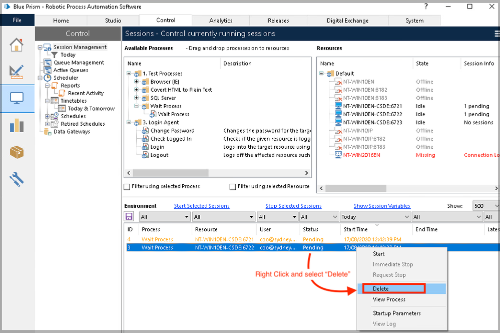

I can create and delete the pending session manually via the GUI. Any ideas?
You can delete the pending session from Control room by right click --> Delete. This is our recommendation.
