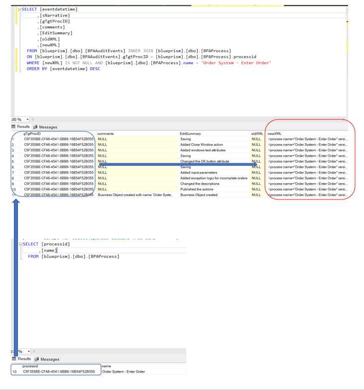

Hi Neeraj,
If you have the access to the database, copy the XML and paste it in some notepad file with .XML format and you can reimport the object after executing the following query:
Replace the <YOUR PROCESS NAME> attribute with the name of the process which you can see in the 'BPAProcess' table for which you need the XML. Here the top most record will give you your desired XML value from the [newXML] column
SELECT [eventdatetime]
,[sNarrative]
,[gTgtProcID]
,[comments]
,[EditSummary]
,[oldXML]
,[newXML]
FROM [blueprism].[dbo].[BPAAuditEvents] INNER JOIN [blueprism].[dbo].[BPAProcess]
ON [blueprism].[dbo].[BPAAuditEvents].gTgtProcID = [blueprism].[dbo].[BPAProcess].processid
WHERE [newXML] IS NOT NULL AND [blueprism].[dbo].[BPAProcess].name = 'Order System - Enter Order'
ORDER BY [eventdatetime] DESC

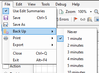

Did you enable the Auto backup option?
Trying to see if we can recover the last auto saved XML.

09-06-22 10:37 AM
Hello Tejas- yes this is enabled.
whenever trying to use first option - it throw that error. finally used the 2nd option, but all work was found lost.
wondering whether that work was ever saved in Db or not

09-06-22 10:42 AM
BP stores all auto backups in the BPAProcessBackup table.
If you have access to DB please try to grab XML from this DB table and see if it helps.

Hi Neeraj,
,[sNarrative]
,[gTgtProcID]
,[comments]
,[EditSummary]
,[oldXML]
,[newXML]
