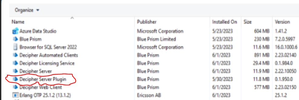

We have installed below version 0.1.950.0 Decipher Plugin. Can I install same version or any updated version. Given below complete installation item. Please suggest. If I reinstall any higher version is there any compatible issue?
Pralay
Pralay Das
Hi Pratay,
That's the correct item to reinstall.
It might be worth downloading the latest installer (0.1.984.0) from the portal, but I don't think the update is substantial.

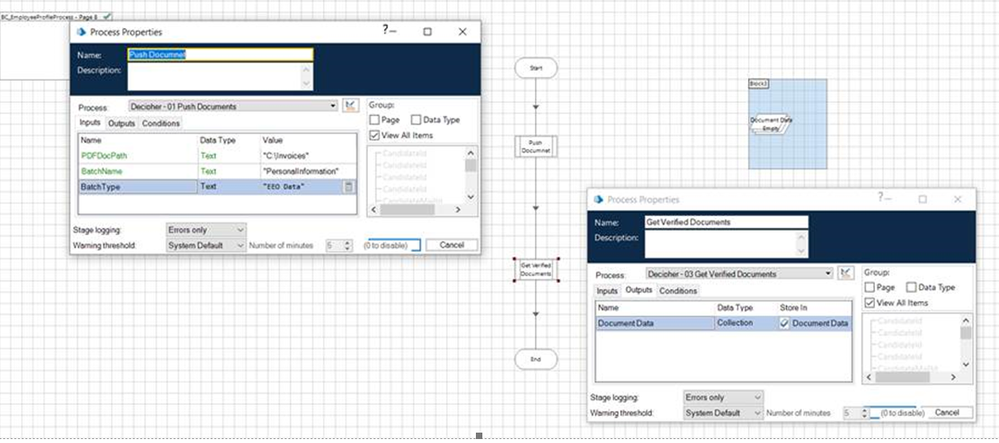

I am created in process studio below code. Can you please check is that fine to get data from decipher to Blue prism process.
And can you suggest where I need to configure property in Decipher that automatically Batch submit in decipher when I Push Data from above process studio.

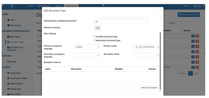

I tried to go to Admin Tab- Document Type – Edit document type but can't find Enable/Set Automatically Skip data Verify option to select to On. Given below is the screen shot. But unable to get that property . I think if this property set  to On Batch will automatically submit in Decipher. Please correct me or suggest me if I am wrong. Given below is the screen shot of Decipher Document Type screen when I Edit DFD.

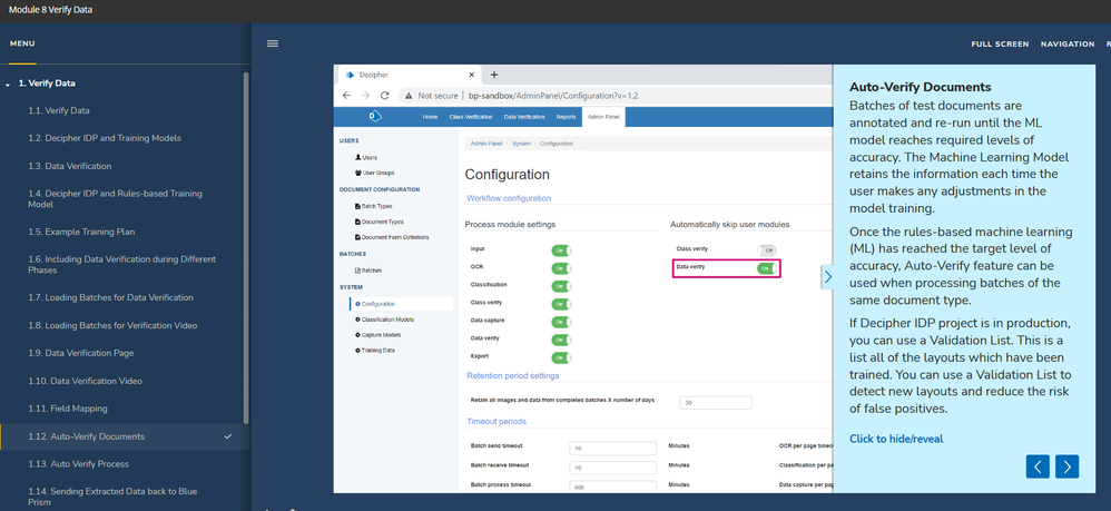

Auto-verification is covered in module 8 of the training part 1.12. Have you tried the step mentioned in the screenshot from the course?
