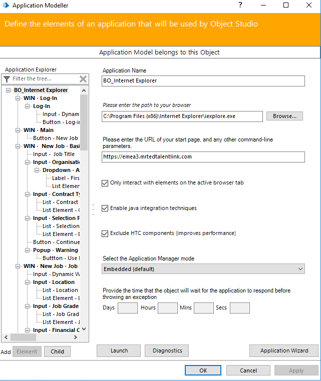

Can you post the screenshot for "Launch" Action and the application modeler configuration if possible?

We are running into the same issue (BP 6.6.0)
When running the process via Studio, everything works fine. If we run it with the same user but via Control Room, the "Launch" throws the following error:
ERROR: Internal : Failed to perform step 1 in Navigate Stage 'Launch' on page 'Launch' - There are no more files. (Exception from HRESULT: 0x80070012)
The navigate stage simply performs the "Launch" on the application. Please find the application model description below.

try uncheck only interact with elements on active browser. Try after launching to attach, so put a step to attach by pid. It might be a process and doesn't know which is the correct pid to attach.
