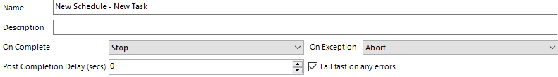

Maybe there is some confusion.
A Schedule can have several tasks.
Each task is executed sequentially in a workflow define by final state (On Complete / On Exception)
A task can have several sessions that are started in parallel
Could you provide some screenshots maybe?
