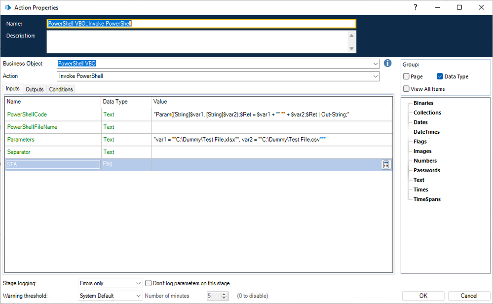

@BaileyHedstrom
Hello Bailey,
try it on this way:
It seems that ​$Args as undeclared parameters doesn't work in this context.
In your case PowerShellCode:
"Param([String]$var1, [String]$var2);Import-Excel $var1 | Export-Csv $var2;"
Parameters:
"var1 = ""D:\RCS_BluePrism\RQA Alerts\Input\Archive\PsTesting.xlsx"", var2 = ""D:\RCS_BluePrism\RQA Alerts\Input\Archive\PsTesting.csv"""
Best regards
Stefan

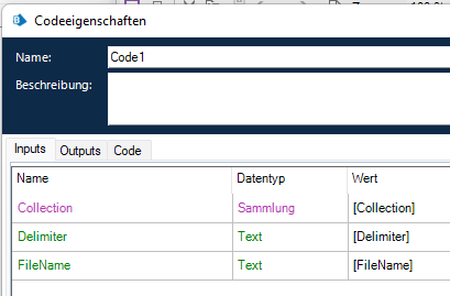

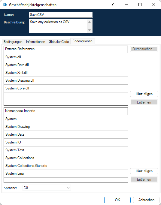

in my opinion you could use as an alternative a Code Stage instead a PowerShell​ script, to write a collection of any size to a CSV file. Here my try:
//-Begin----------------------------------------------------------------
void AddText(FileStream fstream, string value) {
  fstream.Seek(fstream.Length, SeekOrigin.Begin);
  byte[] info = new UTF8Encoding(true).GetBytes(value);
  fstream.Write(info, 0, info.Length);
  //fstream.Flush();
string[] columnNames = Collection.Columns.Cast<DataColumn>().Select(column => column.ColumnName).ToArray();
using (FileStream fs = File.Create(FileName)) {
  AddText(fs, string.Join(Delimiter, columnNames) + Environment.NewLine);
  foreach (DataRow row in Collection.Rows) {
    string[] fields = row.ItemArray.Select(field => field.ToString()).ToArray();
    AddText(fs, string.Join(Delimiter, fields) + Environment.NewLine);
//-End------------------------------------------------------------------
Here the inputs:
Here the references:
Please try this solution with your use case and let me know your results.
fstream.Flush is not really necessary, with large amounts of data it could a reason for performance problems, so I have commented it out. I implemented it to make sure that the data is always written. The code is very simple, the collection is written line by line to the file stream. Since I don't have large amounts of data, I would be interested in the performance. For an approach with PowerShell it is not yet clear for me how to transfer, or better reference to, the collection to the PowerShell automation object.
I am looking forward to hear from you.
