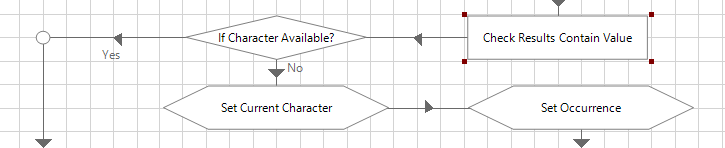

Once, you got this collection we would iterate through this collection using a loop stage. Now create a predefined collection called 'Results' with following schema:
Now, we will check if the current character value in the Split Values collection exists in the Results collection or not using the 'Collection Contains Value' action from 'Utility - Collection Manipulation'. It will return a flag called 'Character Available' which we will check using a decision stage and if the value is True we would skip the current iteration and if the value is False we would proceed ahead. This decision tells us if the Results collection already has that unique character with the occurrence value or not.

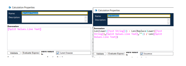

If the value of the flag is False, we would set two data items called as 'Current Character' (Text) and 'Occurrence' (Number) with the following calculation stages:
12214.pngThe logic here is pretty simple: for current character we would simply set up the current character row which we are getting from 'Split Values' collection whereas for the occurrence we will use the logic as:
Len(Lower([Test String])) - Len(Replace(Lower([Test String]),[Split Values.Line Text],"")) / Len([Split Values.Line Text])​
What it does is let say you have a word called as 'Apple' and we need to get the occurrence of the letter 'p' so we first take the length of the word 'Apple' which is 5 and the we replace the letter 'p' with blank in that word so that the word becomes 'Ale' and then we get the length of the resultant word which is 3. So now we take the difference between the lengths which is 5-3 = 2 and we divide this by the length of the letter which we need to find the occurrence for that is 'p' which will be 1.
Hence, the occurrence is equal to 2/1 = 2 so 'p' occurs 2 times in the word 'Apple'
