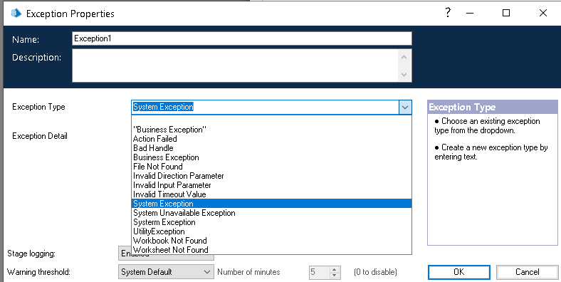

Currently, the Exception Types are created by users manually typing into the combo box within the Exception Stage's properties.
This often leads to multiplication of the same exception type due to typos, misunderstandings, etc.
Example below:
This in turn becomes a nightmare when it comes to reporting, as often a hard set rule cannot be followed for extrapolating these from the overall pot.

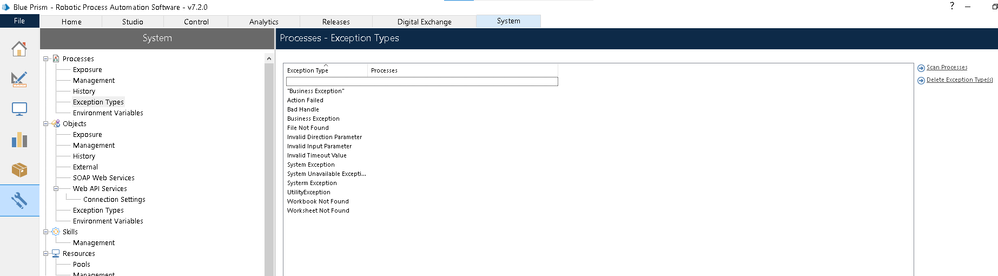

I suggest removing the ability to add new exception types by typing into the combo box, and instead make it a privileged action within the System settings.
For example within the already existing Exception Type screen:
This could be done by implementing an "Add new exception type" action on the side panel, below the already existing "Scan processes"
