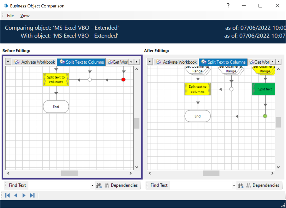

You can compare changes in blue prism but comparing the old and new version of the process/object and it should clearly show where changes have been made.

Thanks for your swift reply! I am aware of the compare window but prefer not to use it.
This is of course easiest as you don't have to do a thing in the process to see the changes. But it requires you to bringing up that window time and time again where I would like to see changes 'live' in the process while I'm working in it. Also, while having a data item or action properties window open in your process, you cannot open the compare window any more - something that I consider a major bug in BP.
